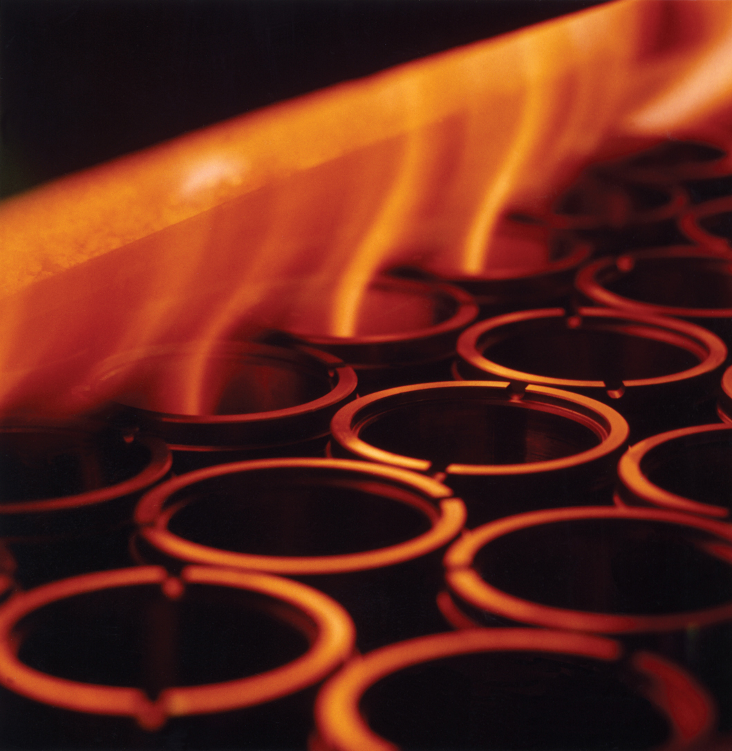

Standard rolling bearing steels
For most industrial applications, standard through hardened rolling bearing steel (100Cr6) is sufficient. This versatile material is heat treated (martensitic-hardened and tempered at low temperatures), which provides consistently high hardness (between 62 and 64 HRC) distributed over the circumference and cross-section. The main attributes of this material are high hardness and wear resistance, as well as good resistance to over-rolling (solid particles can produce surface indentations of raceways in rolling-sliding lubricated contacts).
Depending on the wall thickness of the components, it may be necessary to use a higher-grade alloy taking account of hardenability. The material also permits operating temperatures up to 120 deg C, with some grades offering up to 200 deg C. Typical applications include small combustion engines and fan bearings for steel mills.
A slight variation on the above is bainitic hardened 100Cr6 steel. With this material, there is a considerable reduction in the risk of crack formation, even with surface damage. Typical applications for these bearings include wheelset bearings for bucket wheel excavators and trams.
Case hardened steel (St4) in rolling bearing quality has good forming characteristics and provides high hardness and wear resistance, as well as good resistance to over-rolling. This material is well suited to small components that are manufactured in high volumes, such as universal joints, drawn cup needle roller bearings with closed ends and swing arm bearings.
If there is a high risk of particle over-rolling and poor lubricating conditions (e.g. refrigerating compressors, gearbox bearings for construction/agricultural machinery), carbonitrided steel (100CrMnSi6-4) is the preferred choice. This material is heat treated to provide excellent dimensional stability and hardness up to 66 HRC in the outer functional layer by using increased residual austenite content. The result is a material that provides higher resistance to surface damage and high wear resistance, leading to extended bearing life in poor lubrication conditions, especially where there is a high risk of contamination.
