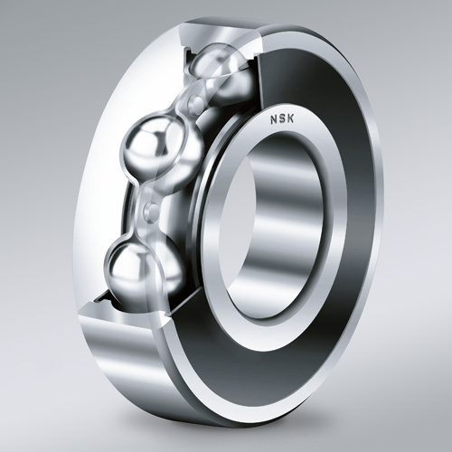

NSK then recommended the use of heat-stabilised bearings which are suitable for temperatures of up to 200°C. Thanks to NSK’s extensive materials expertise, the company has several materials in its portfolio which are compatible with high surrounding temperatures.
The seals on the new bearings are also designed to cope with the specific conditions. The furnace’s conveyor system is now fitted with deep-groove ball bearings featuring Viton seals, which means that the bearings can handle temperatures of up to 150°C. In addition to this, the seals keep ambient contamination out much more effectively than the shielded bearings previously used.
