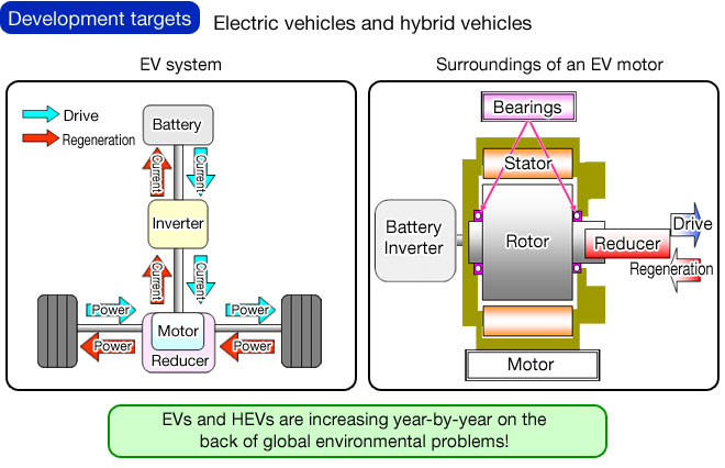

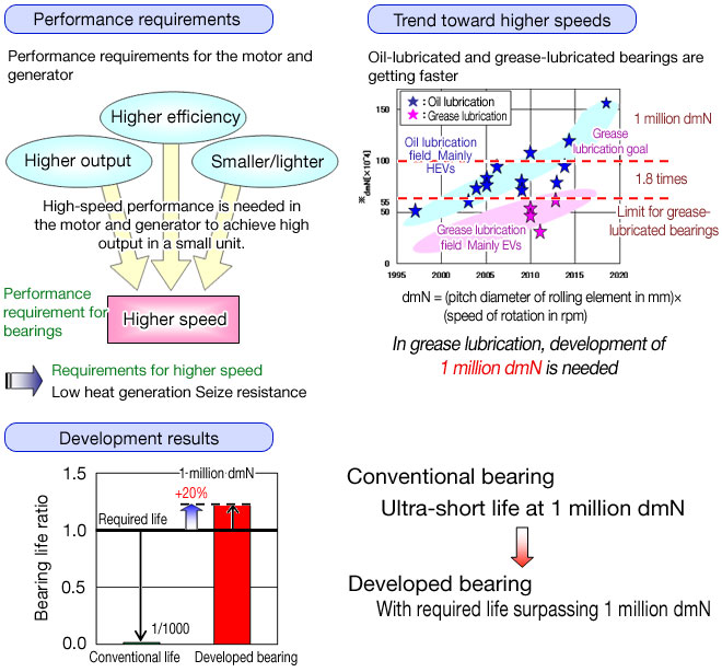

In recent years, automobile manufacturers’ need for high-speed rotation has been increasing in order to ensure power output. The need exists to simultaneously downsize and lighten drive motors and power generators to extend the running distance and improve the electricity/fuel consumption in EVs and HEVs. Bearings that support motors include oil-lubricated bearings and grease-lubricated bearings, both of which need to provide high-speed performance. Grease-lubricated bearings have the advantage that they enable a more simplified surrounding structure than that of oil-lubricated bearings. On the other hand, they present a difficult challenge in terms of achieving the necessary high-speeds.

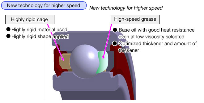

1.The use of a highly rigid and lightweight cage with an improved shape made from a new resin material optimizes ball movement and enables high-speed rotation.
2.Optimization of the grease composition achieves improved bearing longevity under high-speed rotation.
•Suppression of heat generated during high-speed rotation by adoption of a low-viscosity base oil with good heat resistance.
•Furthermore, low tourque (low heat generation) has been enabled by selecting a thickener with outstanding fluidity

This product will contribute to the downsizing and greater efficiency of EV and HEV systems by achieving high-speed motor rotation (one million dmN).
