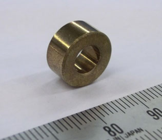

Compared to white cooper materials
(1) Same or better corrosion resistance
No patina (rust) generated in JIS salt spray test
(2) Same 0.1 or less coefficient of friction
(3) 9-times or more wear resistanc
[ Product photo ]

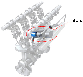

[ Example application ]
· Fuel pumps for automobiles and motorcycles
