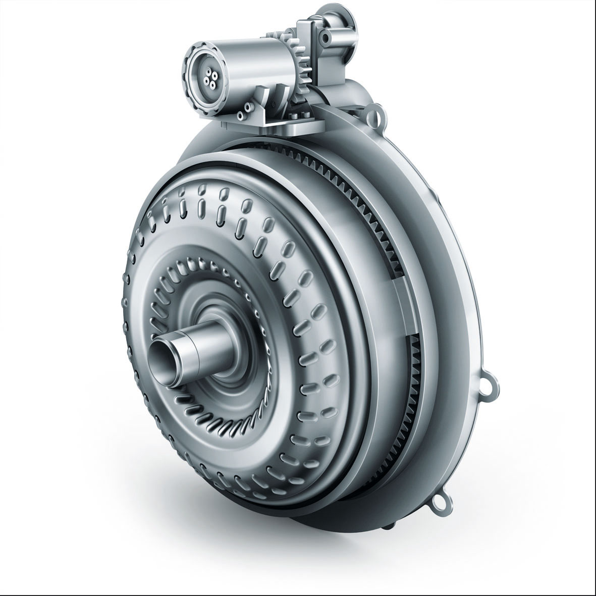

However, these solutions can be efficiently replaced by innovations from Schaeffler, such as the company’s latching valve. This valve, developed by Schaeffler, is activated by a hydraulic pressure pulse before the engine stops, which causes a small volume of pressurized oil to be stored in one of the transmission’s switching elements for the subsequent start-up operation, thus allowing a more rapid closure and helping to ensure that the vehicle has the necessary acceleration capability. Since the signal is given hydraulically, there is also no need for plug connectors or wiring.
A further requirement placed on modern start-stop systems is a quick and comfortable engine restart. This applies not only to starting after an extended standstill period with the engine switched off, but also (and in particular) to so-called “change of mind” starts, i.e. when the driver quickly decides that she/he wants to accelerate again while switching off the engine. Schaeffler’s new developments offer attractive solutions for optimization in these situations. Schaeffler’s wrap spring one-way clutch for permanently engaged starters is a solution developed by the company for integration into the housing of the torque converter. This allows fast and silent restarting, and also supports additional functions, such as “sailing” or driving at high speeds with the drive train decoupled and the internal combustion engine off. The permanently engaged starter generator encircles the torque converter by means of a wrap spring. This means that only a small amount of axial space is required. A spring-based, one-way clutch is used to engage the torque converter when the starter is activated. When the engine is running, it is decoupled from the torque converter (thus preventing wear) and the starter remains at a standstill despite being permanently connected to the drive train.
