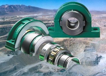

This is particularly true of bearings and is one of the major reasons why companies in all industries are increasingly turning to Revolvo’s SRB split roller bearings as a means of reducing downtime. So why bear the additional initial purchase cost? The answer is threefold: initial installation time can be reduced by up to 90%; bearings can be inspected in situ; and the ease and speed with which SRB split roller bearings and housings can be replaced if there is a maintenance issue.
Unlike solid bearings, SRB split roller bearings are totally split to the shaft; a design that both simplifies and expedites installation and cuts downtime when compared to replacing solid bearings of the same size. SRB split bearings allow the shaft to be supported by the lower section of the bearing; while the top section can be removed, making bearing inspection simple, without the need to remove drives or the shaft itself. This intrinsic feature is especially valuable with regards to large machines, where sheer weight and size can be a barrier to fast and effective servicing.
