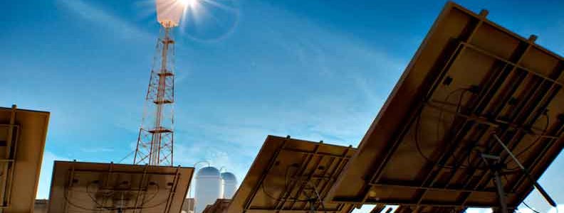

The use of reliable and precise solar tracking solutions supports such cost-reduction ambitions. Whether it involves photovoltaics (PV), concentrating photovoltaics (CPV) or concentrating solar power (CSP) (fig. 1), SKF offers an extensive range of maintenance-free solutions related to solar tracking. These encompass innovative products such as SKF Solar Linear Actuators (part of the SKF BeyondZero portfolio) and the SKF Solar Hub developed specifically for the solar market (fig. 2). Both products are designed, assembled, tested and validated by SKF. Furthermore, SKF provides maintenance-free bearing solutions with the possibility of integrating them with housings that are fully sealed for the life of the product.

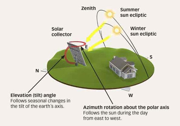

Tracking systems are important features in efficient solar power generation as they help to increase the power output of photovoltaic panels – a dual-axis tracker can raise it by up to 40 % – and to fully capture the sun’s radiation for CPV and CSP systems (fig. 3). To maximize energy generation, these systems need to have high performance characteristics such as robustness and accurate positioning, as well as providing a reliable solution capable of operating in harsh outdoor conditions. A solar tracking system has to track the sun with a certain accuracy depending on the technology. PV technology tracks the sun within ± 1 degree, while CPV technology tracks the sun at ± 0.1 degree. Hence, it is important to have drive systems without too much play, or “backlash”. Otherwise, as the wind blows, the system will rock back and forth, either losing efficiency or not generating any power at all.

Electromechanical actuators, such as the Solar Linear Actuator and the Solar Hub, are used in tracking systems to move the solar panel in an east-west direction (called “azimuth” movement) or a north-south direction (called “elevation” movement), or both.

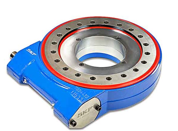

SKF Solar Hub – CRSD 290
The Solar Hub (fig. 4) is the latest product from SKF designed to help increase the efficiency of solar tracking systems. Designed to custom solar requirements, it accurately tracks the sun from sunrise to sunset, throughout the seasons, over the life of the system. The technology offers significant improvements over today’s maintenance-intensive solutions. Designed for a 20-year service life, SKF Solar Hubs require no downtime for part changes and do not need relubrication. Robust design features such as superior material selection, optimized material treatments, improved lubrication and optimal sealing mean that the product is built for harsh environments and extended service life. The SKF Solar Hub reduces operational costs, lowering the total cost of ownership. With its minimized backlash, the Solar Hub enables improved power generation, lowering the levelized cost of electricity (LCOE).

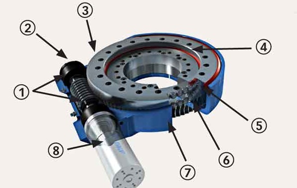

Solar Hub construction
The Solar Hub, CRSD 290 (fig. 5), has been designed specifically for solar tracking applications covering a wide range of panel sizes from about 20 to 70 m2 and can go as high as 90 m2, depending on the tracker design and wind conditions. The CRSD 290 is a rotary drive consisting of a preloaded main bearing arrangement, gear set and housing. The preloading during assembly provides minimal backlash tracking. The worm gear set is designed to have self-locking properties, enabling it to hold a static torque without an external brake. Additionally, the material selected for the gear set combined with appropriate heat treatment offers high torque-carrying capabilities and limited wear, extending product longevity.
Solar Hub – CRSD 290 – main features. 1 Maximum stiffness bearing arrangement 2 Symmetrical motor mount interface 3 Assembled for minimal backlash 4 Optimized sealing 5 Optimal grease selection 6 Double row angular contact bearing for improved stiffness 7 Lubricated, sealed assembled and tested for life 8 Integrated motor (AC or DC) – optional
In the SKF design, sealing has been optimized compared with existing market standard solutions, to provide minimal grease loss during operation, to reduce any environmental impacts as well as reducing the need for relubrication. Thanks to SKF’s knowledge of greases and lubrication, an optimal grease has been selected for this slow-moving application, thus permitting an improvement in performance. As reduction in maintenance requirements has been a key design criterion, the CRSD 290 is virtually maintenance-free, requiring no maintenance over 20 years, in contrast with existing market standards that require annual relubrication. Finally, the complete design is protected in a sealed housing for optimal performance even in extreme conditions and is rated IP 65.

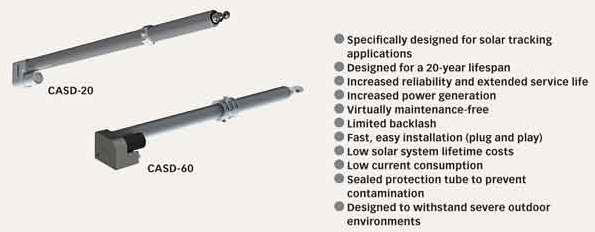

Solar linear actuators

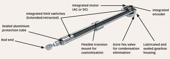

SKF’s range of linear actuators, CASD-20 and CASD-60 (fig. 6), have been developed to meet the same high performance standards as the Solar Hub in terms of increased power generation combined with long life, reliability, ease of installation and no need for maintenance. The linear actuator comprises a screw with an integrated gearbox, motor, bearings, lubricant, two limit switches, hall sensors and a circuit board, all protected in a sealed housing (fig. 7). In this case, performance is achieved through the use of sealed protective tubes for improved reliability and better drive protection even in the harshest environments.
SKF Solar Linear Actuator features
Higher static to dynamic load ratios permit solar power generation even during high wind conditions. For the CASD-20, the respective dynamic and static loads are 5 kN and 20 kN. For the CASD-60, these values are 12 kN and 60 kN. Depending on the static load, both actuators have a stroke of up to 1,500 mm and speed of operation is up to 2 mm/s for the CASD-20 and 2.5 mm/s for the CASD-60.
The CASD linear actuators deliver efficiency improvements such as reduced current consumption, greater positioning accuracy and limited backlash. Being complete units, not only are the actuators easy to install in any solar application, but they significantly cut design and development time while delivering savings in operation.
SKF Solar Linear Actuator CASD-60
