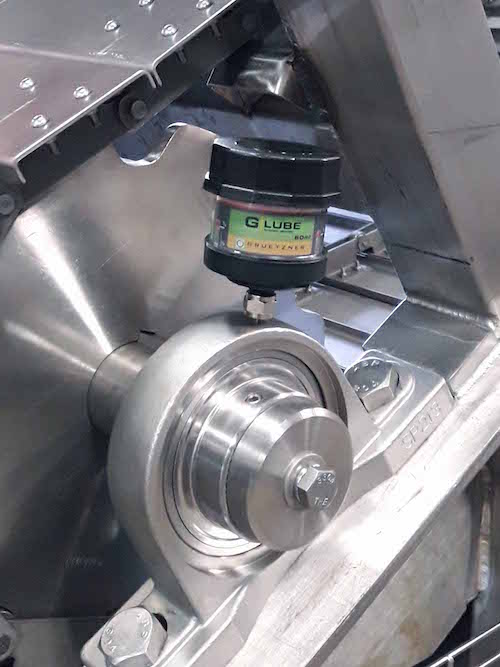

With the G-LUBE automatic lubricator from the German company Gruetzner GmbH, the lubrication point is supplied with the correct lubricant in the correct dosage. The sources of error of manual lubrication (over-lubrication, insufficient supply, contamination, mix-up of lubricants) are thus prevented. A continuous, consistent and gentle lubrication is the result, repair costs and production losses are reduced.
Flexibility:

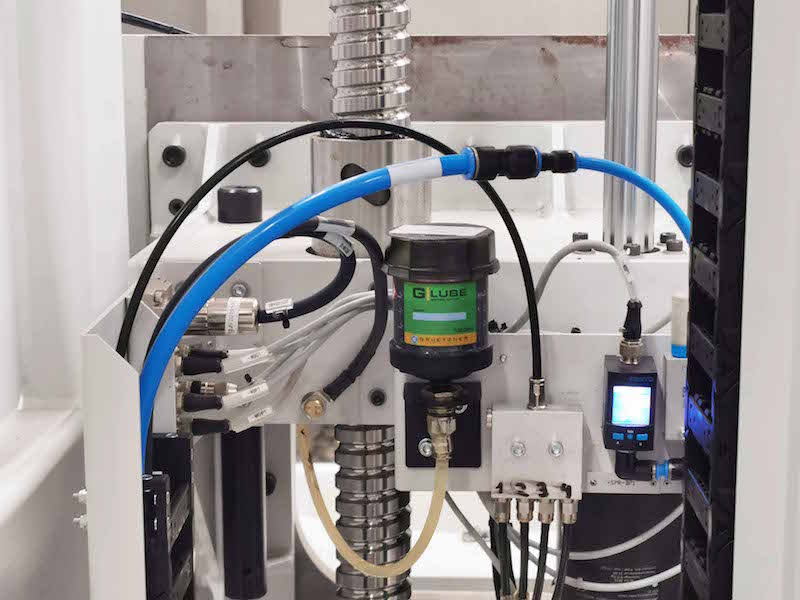

G-LUBE can be visually checked at any time thanks to the transparent housing. Depending on the requirements of the application, emptying times from 1 to 12 months can be set. The sizes of 60 ml, 120 ml and 240 ml enable a lubricant delivery of 0.16 ml / day up to 8 ml / day.
The right lubricant:
Every customer can fill the G-LUBE himself or have it filled with one of the many standard lubricants offered. Special requests are also met by Gruetzner GmbH, even for small quantities. A very wide range of accessories for installation enables a large selection of applications.
Work safety:
With a pressure build-up of up to 5 bar / 73 psi, G-LUBE does not have to be mounted directly on the lubrication point. Supply lines are also possible which lead to areas that the user can comfortably reach. G-LUBE thus contributes to work safety and significantly reduces the maintenance time required compared to manual lubrication. No tools are needed to activate G-LUBE.
Proven technology:

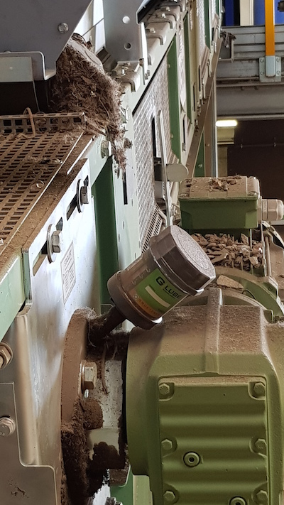

The function of G-LUBE is based on the proven technology of an electrochemical reaction, which generates inert nitrogen (N2) through the systematic use of an electrolyte. This type of pressure build-up means that G-LUBE is more temperature-independent than many conventional gas-powered lubricators. It can be used in temperature ranges from -20 ° C / -4F ° up to 55 ° C / 131 ° F, even in sensitive food areas, but also in harsh environments, thanks to its very robust housing.
