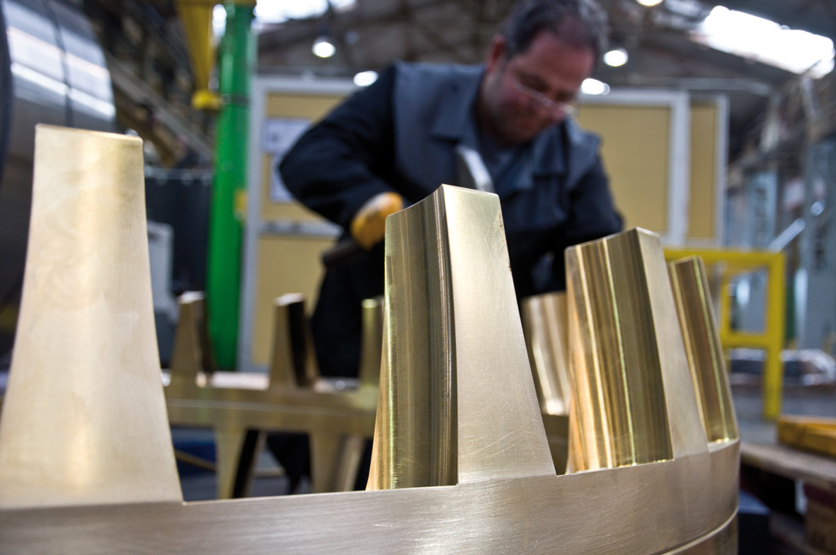

The double row spherical roller bearings are extremely durable with solid brass cages guided on the inner ring and an optimised internal design. The bearings have a very high load carrying capacity (basic dynamic load rating is 37,500kN) and the bore is tapered with a ratio of 1:30.
The size of the spherical roller bearings created special challenges for Schaeffler’s production plant in Wuppertal, Germany. For example, in order to assemble and position the 50kg rollers into the bearings, a special lifting device had to be designed and built. The rollers were manufactured at Schaeffler’s plant in Eltmann, Germany.
